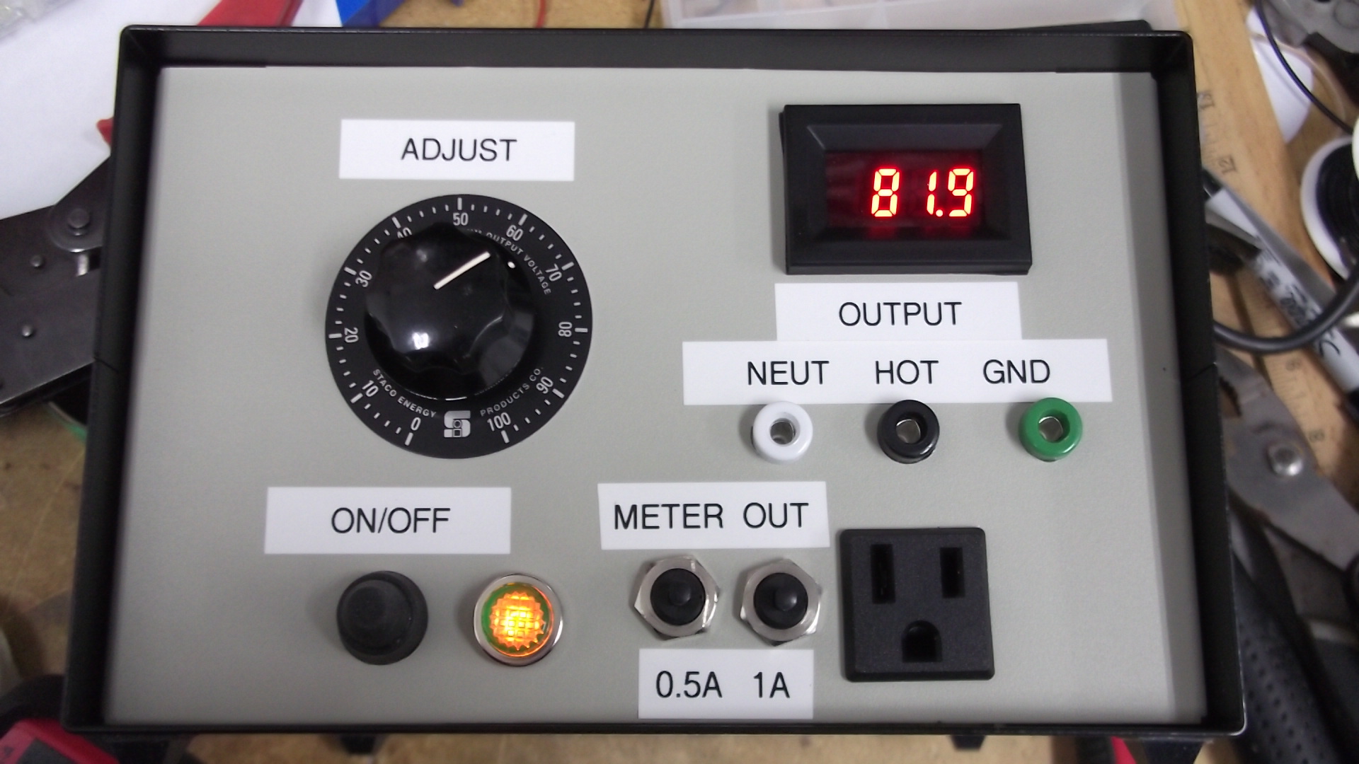

    Built this weekend for slowly bringing up radios with AC/DC power supply inputs.

    I would suggest a minor modification / addition.
    You might want to consider adding a 110 / 220 volt transformer such as those found in 50 watt European adaters, a bridge rectifier, 400 volt filter cap, and suitable resistor, you would have a built in source for reforming electrolytic caps , variable from 0 to some about 400 volts or so or a low power ( 50 watt ) high voltage DC supply.

    Hi John:
    I actually have a circuit capable of producing 0 – 1000 VDC so that could be modified as a reformer to test capacitors up to 630 VDC. It needs some tweaks and additions since I got it off the Internet – I find a lot of schematics on the ‘net nowadays give the appearance of having been tested by their authors but that is not always the case. Hence I do a lot of breadboarding and experimenting before I publish anything so no one has to go through the frustrations I encounter!
    Metering on all my projects is a must so you don’t end up having to buy several meters and the eventual rat’s nest of wires to go with them. The meter I added was not cheap but it works very well – and my nibbler tool got a work out making the rectangular cutout to fit it. Thank goodness for AutoCAD drafting where you can get hole alignments to 0.001″!
