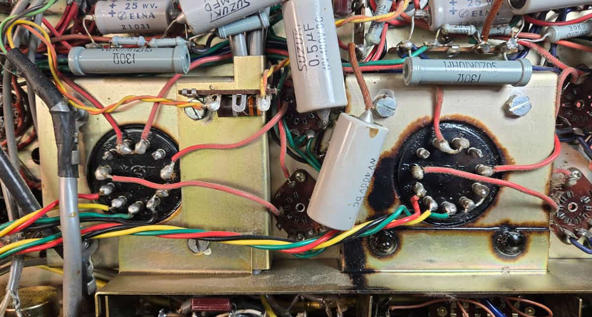

Les DicksonCVRS MemberI have a 1960 Sansui SM-30 (The Super Mighty Transformer) with a leaking output transformer. There are two output transformers – one per channel. There are speaker connections for 8Ω 16Ω and 32Ω. When I test the resistance of the windings on each transformer they are identical so that’s the good news. However, there is some leakage on one transformer. (Picture included)
So, how do I proceed? What are the risks of using the unit as is?

Forum ParticipantHello Les, nice looking unit you have there. That transformer might have gotten hot at some point. I would suggest if the capacitors in the metal cans are original, it may be time to replace them. If there is a short circuit in one of them, excess current could cause overheating.
But because these are output transformers, a possible cause of overheating may have been speaker leads shorted together. Run the amp on the bench and measure the temperatures of both output transformers with a laser thermometer. If they are equal and remain so for more than an hour, say a couple of hours, good chance there was no permanent damage done.
Use the laser thermometer to check resistors, coils and transformers, very handy and prevents burnt fingers too.

Les DicksonCVRS MemberHi John, thanks for your reply to my post. I definitely plan to change the electrolytic caps and also the selenium rectifier.
I’ll check out the temperatures as you suggest.
Someone had added an audio jack wiring it to the speaker terminals so I’ll check that our for shorts.March 18, 2026 at 7:47 am #35596westcoastjohn

Something I’ll add for future readers of these forums, is that a tube amp should always work into a load. You must always have a speaker or dummy load connected to the secondary winding of the output transformer. If not, it may self destruct.
Could be what happened here, almost.This rule contrasts with transistor amp outputs. A power transistor simply doesn’t pass any current when a speaker wire comes loose, so you can power up a transistor amp or radio without the speakers and nothing bad will happen. “The vacuum tube is a voltage device, while the transistor is a current device.” Jn
