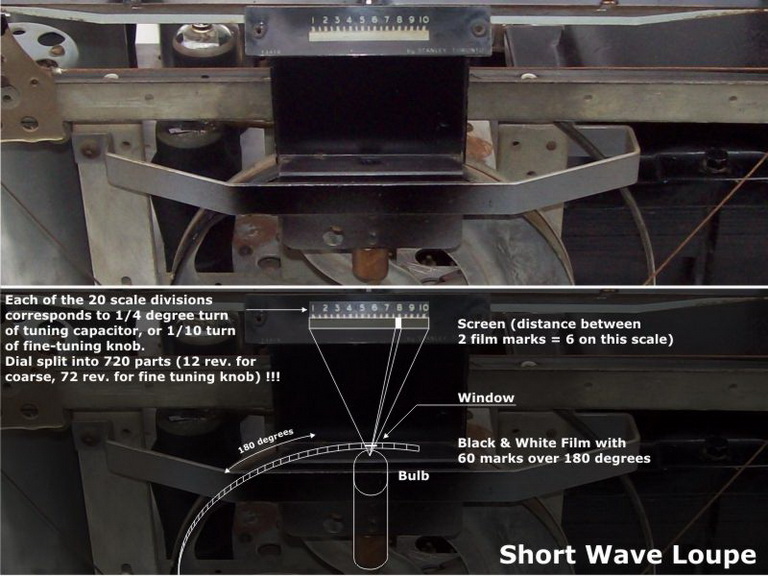

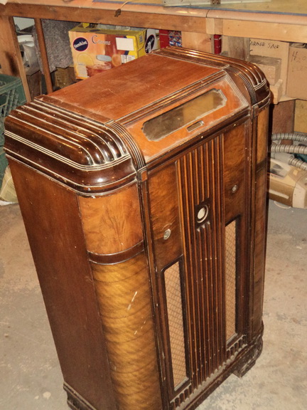

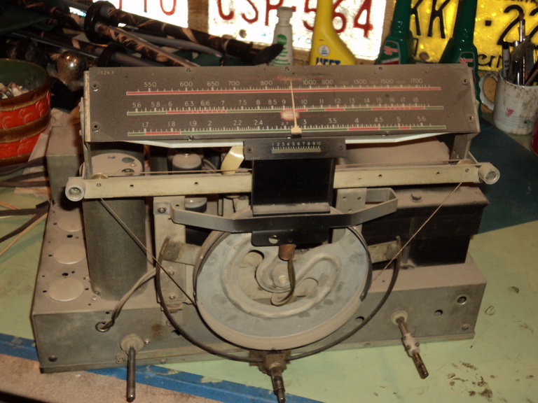

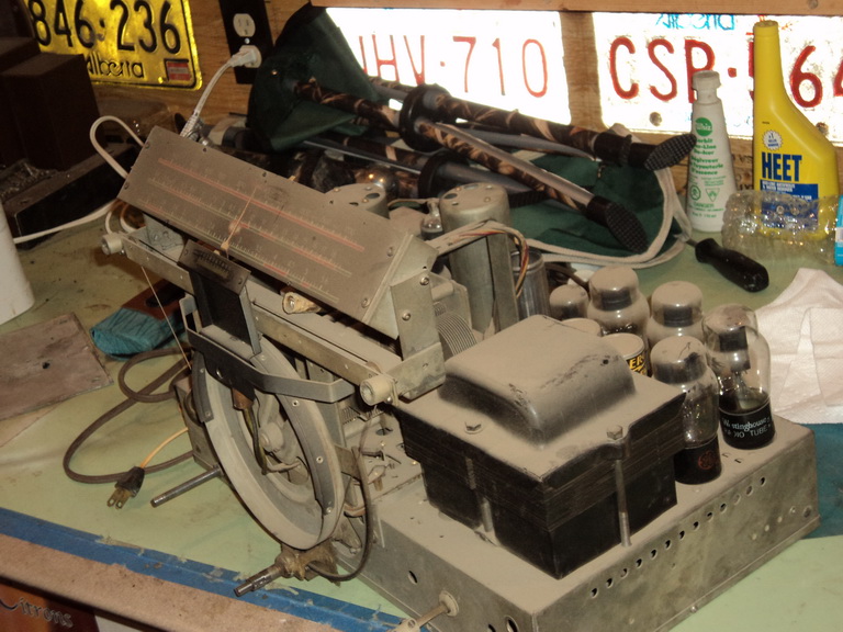

    I drove from Calgary to Edmonton for this Rogers Queen Elizabeth model 11-11[ 6R1131] It has two 80 rectifiers and push pull 6F6s as output tubes it has variable IF cans. It also has a tuning light[24 volt]. besides the tuning light ,it has a tuning indicator, which I still have to look at and set up. [see photo] I now have it recapped playing very good.. I will be keeping this one, as the cabinet is original, but will need a little work.
