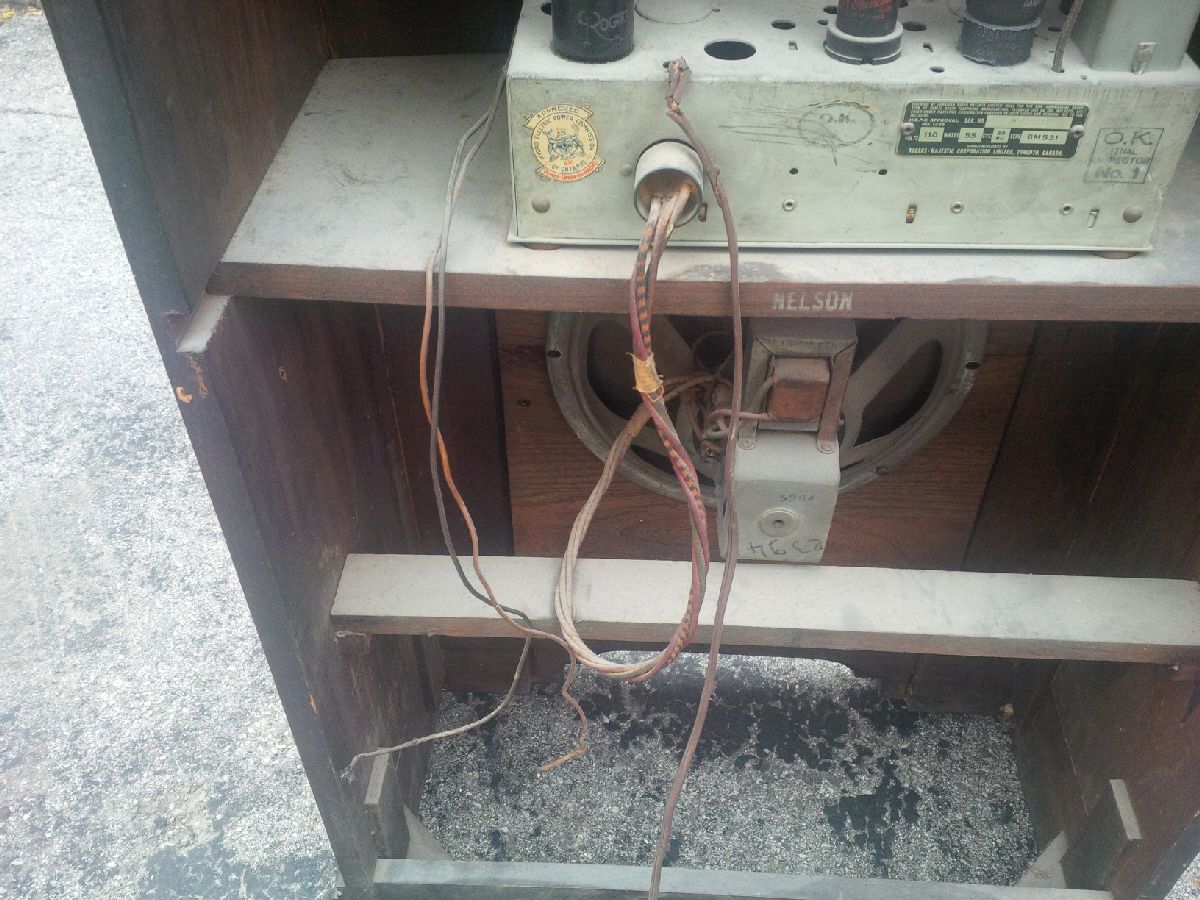

May 18, 2016 at 5:07 pm #7797HolderAccount
Forum ParticipantIf you take a look at IMG908 on the LHS of the chassis you will see that there are two holes. Those holes are where capacitors # C40 and C41 used to sit. Looking at the chassis layout in the linked schematic confirms this. Also looking at the schematic shows that ONLY C41 has a negative side connected to the chassis Watch for this when you replace them. While this is not “uncommon”, it is more common for the negative sides of filter capacitors to be connected together and also to the negative side of the high voltage circuit (B-).

https://www.radiomuseum.org/r/rogerstube_majestic_cornwall_ch_6m53.htmlFebruary 26, 2023 at 8:20 am #24209Dan Walker
CVRS MemberI have the table version of this radio.
. I can’t tell by the photos ,but there should be a tube [looking from the rear] at the front right .
Those two holes you see are where there used to be two electrolytic capacitors. [C40 and C41]
They were probably replaced sometime in the past with newer ones mounted under the chassis.
