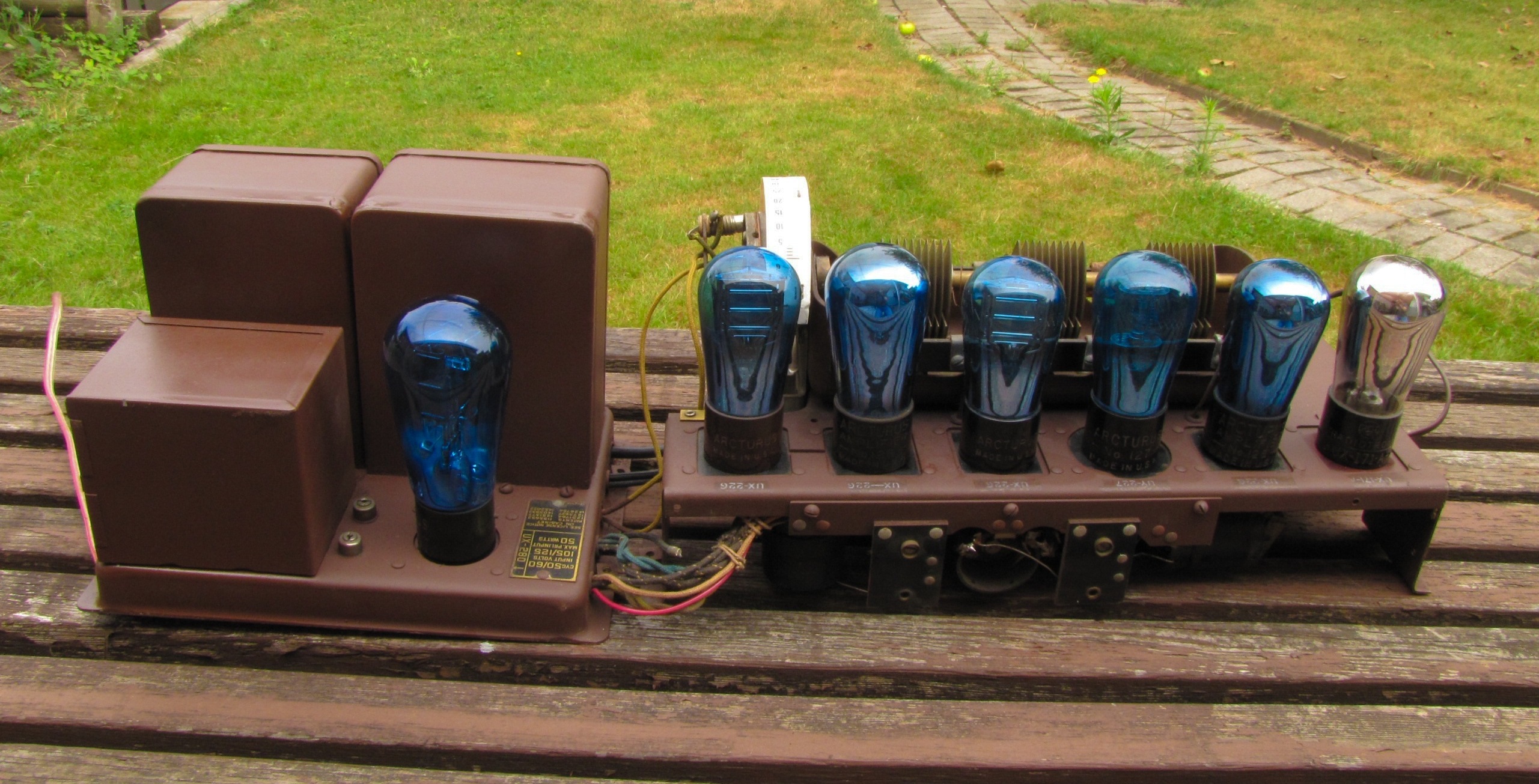

    Radiola 33 with intact pot metal trim and 100B speaker. It had been previously painted, so the ugly fake woodgrain finish was already covered. I’ve recapped it and added line filters to get rid of the modulation hum.

    Even if I didn’t find the original finish ugly, I would have been out of luck with this one. It was painted in dark brown enamel at some point before I got it. Luckily, it doesn’t seem to be affected by any pot metal rot (a random batch of good metal), so it’ll probably stay like this for a while.
    The speaker is working too, and the electronics didn’t require a lot of work. All of the chokes & transformers were good, so that was more luck. To be honest, it sounds great, especially if I hook it up (with a proper transformer) to a modern speaker.
    The Arcturus tubes work, but they are more for show and cost a lot more than this radio did, but they are contemporary with the unit. It isn’t a museum-quality restoration, of course.
