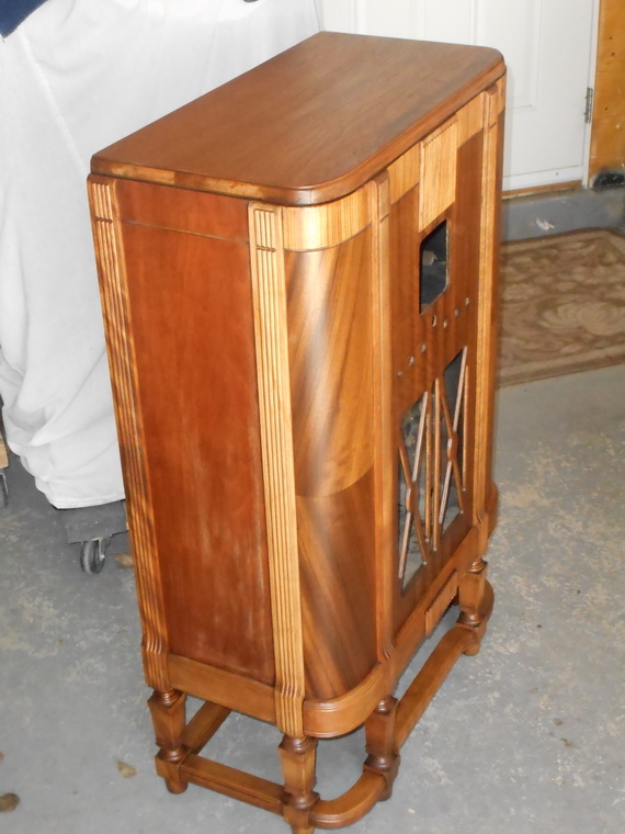

CVRS MemberIt is not like I am short of radios , BUT this one came along and I like the style and the cost was cheap
so I bought it.
The cabinet will be easy to strip, but it needs to be re glued in a lot of places, including a new top.
All the knobs are there , and I have heard that they don’t make repos of this knob. the grill cloth is good,[but wrinkled].
It is a GE model M106 which uses the same chassis as the RCA model 262 with ten tubes.
sometimes I feel that I am the only one who posts here, but I suppose someone will see the photos.

June 7, 2019 at 8:05 am #11528Dan Walker
CVRS MemberI have the radio up and running now, and have the cabinet ready for the last stages of restoration.
I had to re glue a lot of the cabinet and add a piece on the front of the top. it was easier than replacing the whole top veneer.
I have stripped it and gave it a coat of dark Walnut stain.
The next step is applying Mohawk Van Dyke brown toned lacquer to the pillars and the legs.
then Extra dark walnut to the top edge , apply the decals, install the grill cloth and chassis
I will post photos of the completed radio.
I think it will come out pretty good.

June 7, 2019 at 4:56 pm #11533Dan Walker
CVRS MemberI just replaced a strip about 1.5 inches wide , across the front of the top.
You can see a darker portion along the front of the top.
I have the toner on now but I still have to put the decals on.
It is hard to contact anyone on this forum, even to send them a PM
I don’t know how you can do it , maybe contact the administrators????
Dan in CAlgaryJune 7, 2019 at 6:32 pm #11534Dan Walker
CVRS MemberHere are the latest photos of the radio..
All that is left to do is grill cloth, decals ,install the chassis and put on the knobs.
I think it is going to look pretty good, considering what I started with.
BUT I don’t know where I am going to put it
More photos after it is all done.June 13, 2019 at 10:23 am #11543Dan Walker
CVRS MemberI now have this one all done and it looks pretty good considering what I started with.
Here are the final photos.
