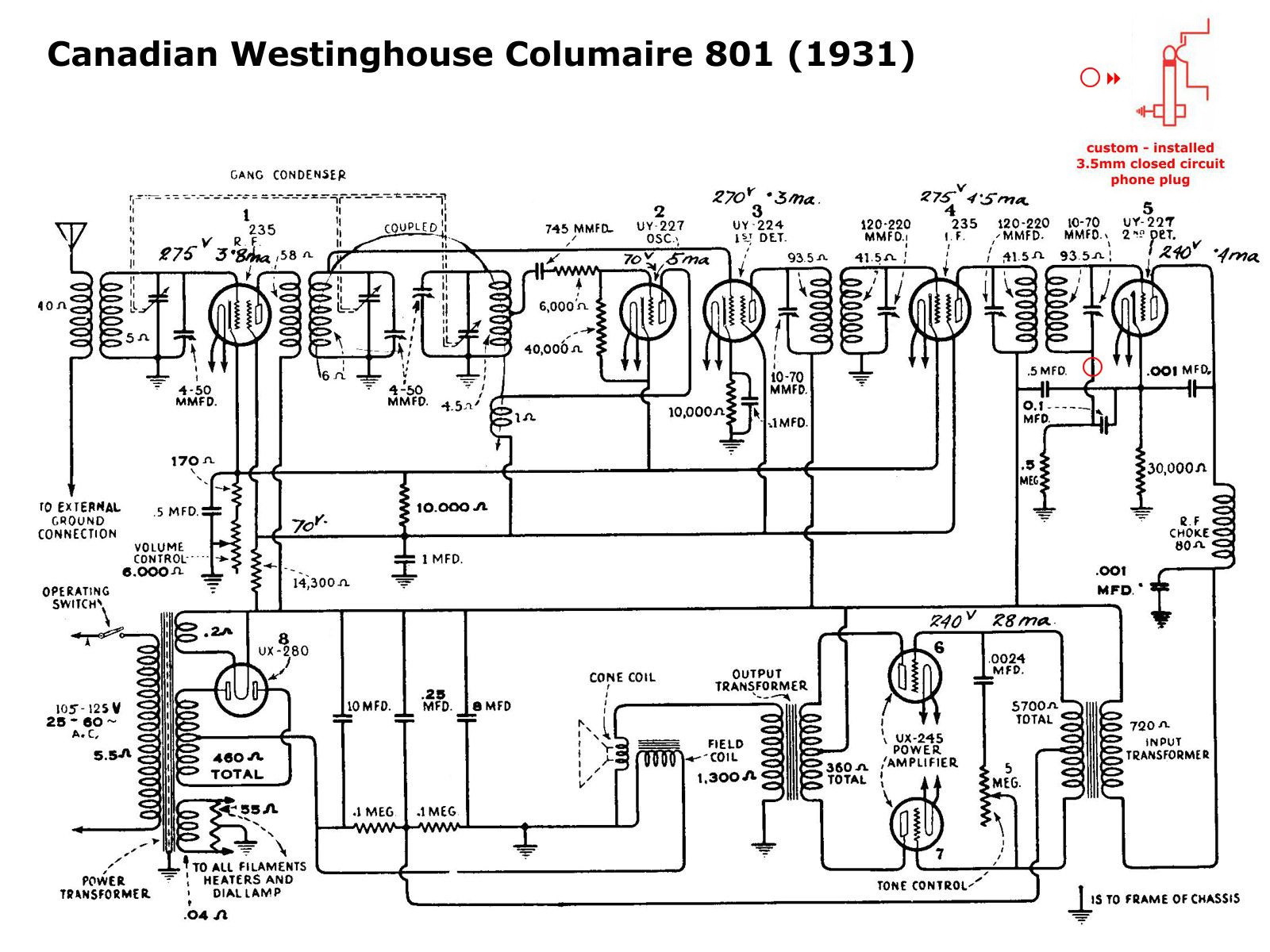

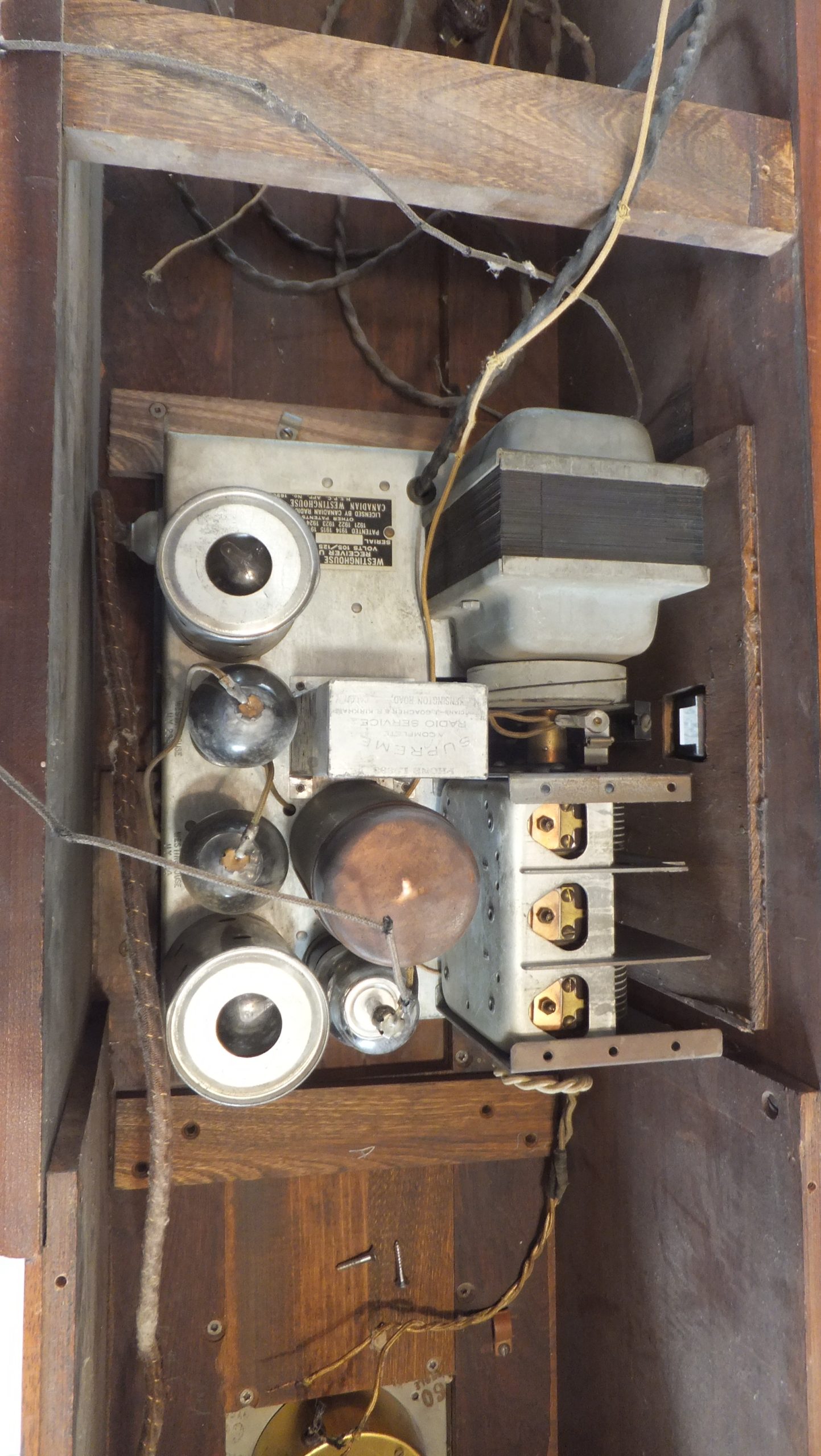

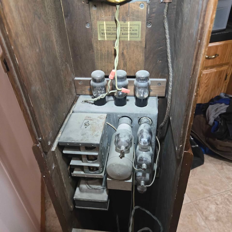

I need some help with a Westinghouse columnaire model 801. Someone has been in there before me and sort of messed things up.
