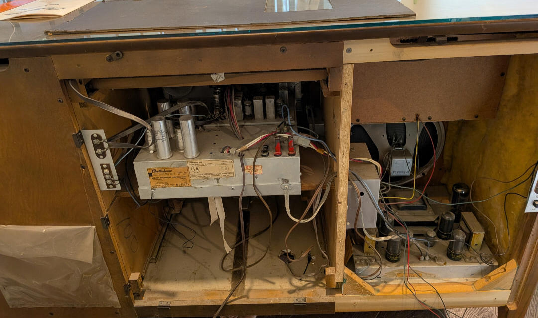

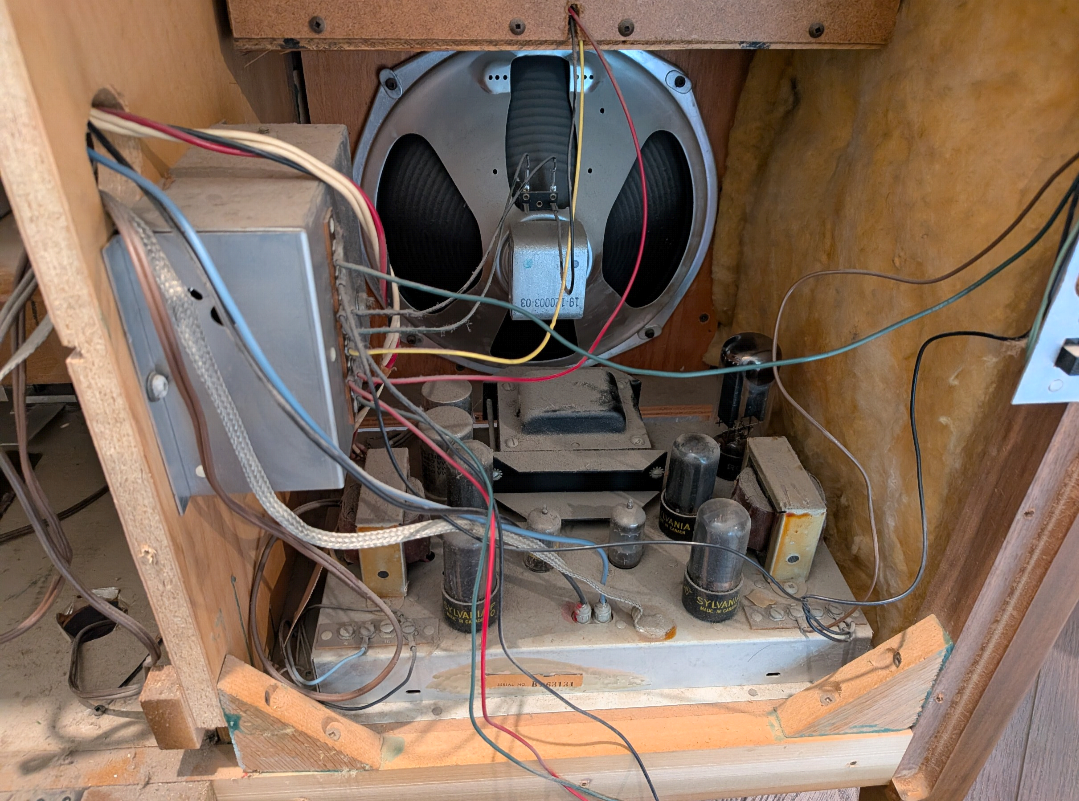

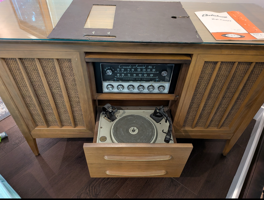

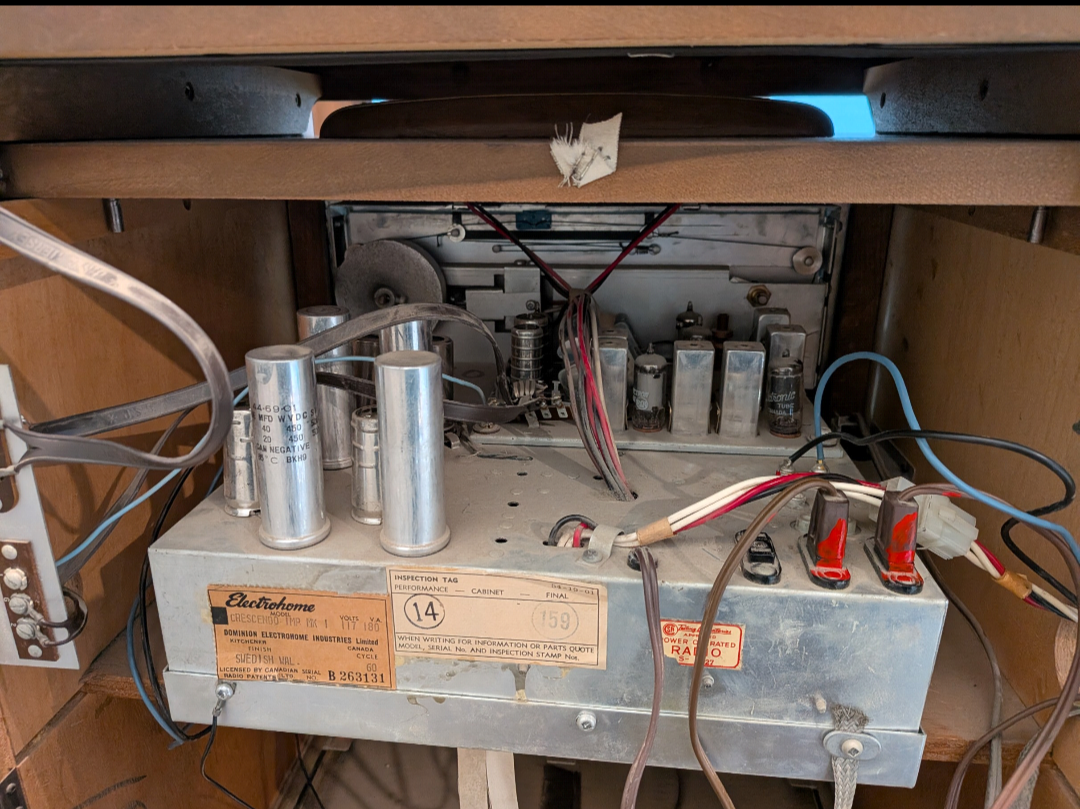

September 15, 2026 at 3:20 pm #36625SmittyNA
Forum ParticipantA few pictures of the unit

Forum ParticipantHello Smitty. Your resistance test of the power cord shows that the primary winding of the power transformer is OK. Then when you applied power, you discovered a short circuit. Check the large electrolytic capacitors, power off, with your ohmmeter. Then check the others. Find a shorted cap and you’ve found the problem.
If no joy, pull the rectifier tube, that will prevent high voltage in the circuit, the most likely cause of the blown fuses. Unplug the tuner from the main power amp to narrow down the issue. Check for shorts everywhere you can reach. Then you can try putting 12 volts AC to the power cord, with fuses installed. Measure voltages at the empty rectifier socket and multiply them by 10. If things get warm, you still have a problem, cut power.
The critical part is the power transformer. If it can be powered up at low input AC volts and stay cool with correct output voltages, then you can move ahead. If it can tolerate 120 VAC with no load, no rectifier and all tubes pulled, and doesn’t get warm, you are laughing, but still need to find that short.
