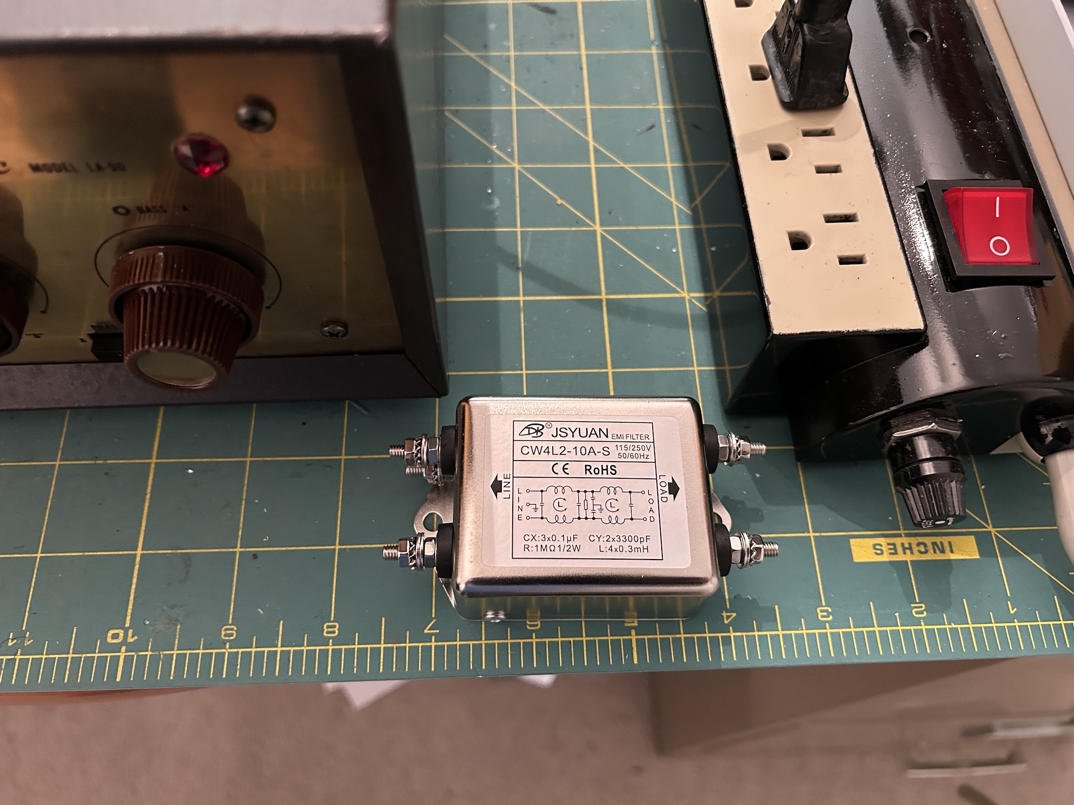

    Try adding an EMI filter. I get a lot of electrical “Noise” in my house wiring and had to build a power bar with a 10Amp EMI filter installed in it. I had similar problems until I started using the EMI filter.
    #36561
    Tom Stevens
    Also, if you get an EMI filter, DO NOT connect the ground wire. None of my radios or power supplies have 3 pin plugs so the ground is irrelevant. I was getting a noticeable hum when testing TRFs with ABC power supply and also my vintage stereo stuff and the EMI filter cleared it right up. See attached photo

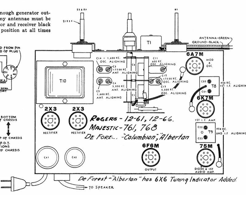

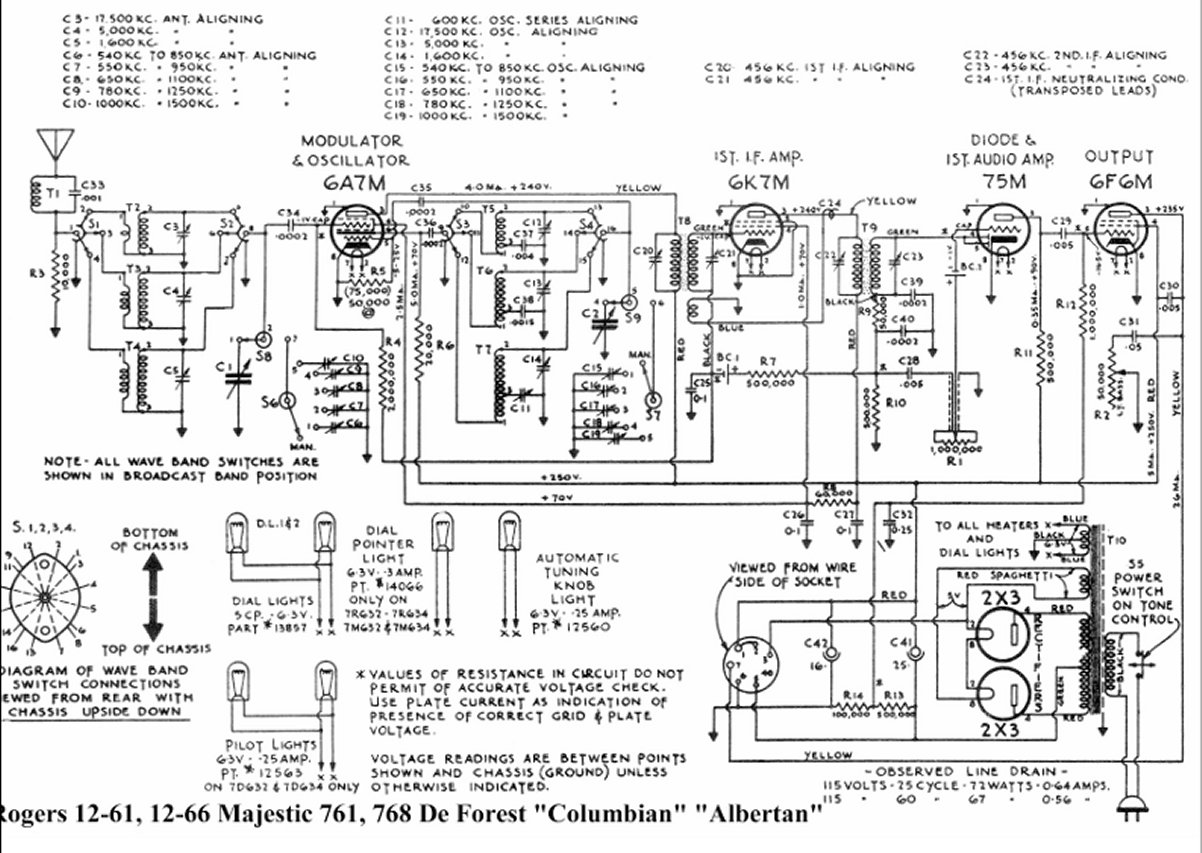

    Here’s a link to the schematic and a couple of clips that we can study. Nothing like a bit of homework, oh yeah.
    https://pacifictv.ca/schematics/rogers12-61data.pdfHopefully the noise is controllable but if it is indeed an internal problem, we can find ways to eliminate it on the schematic. Maybe. 🙂
    • This reply was modified 2 months, 3 weeks ago by westcoastjohn.
    #36569
    westcoastjohn
    Let us know if this info matches your set. They are ID’ed more by given name than by number, but there are duplicate chassis in the Majestic and Rogers cabinets,
    3 different cabinets have identical schematics.
