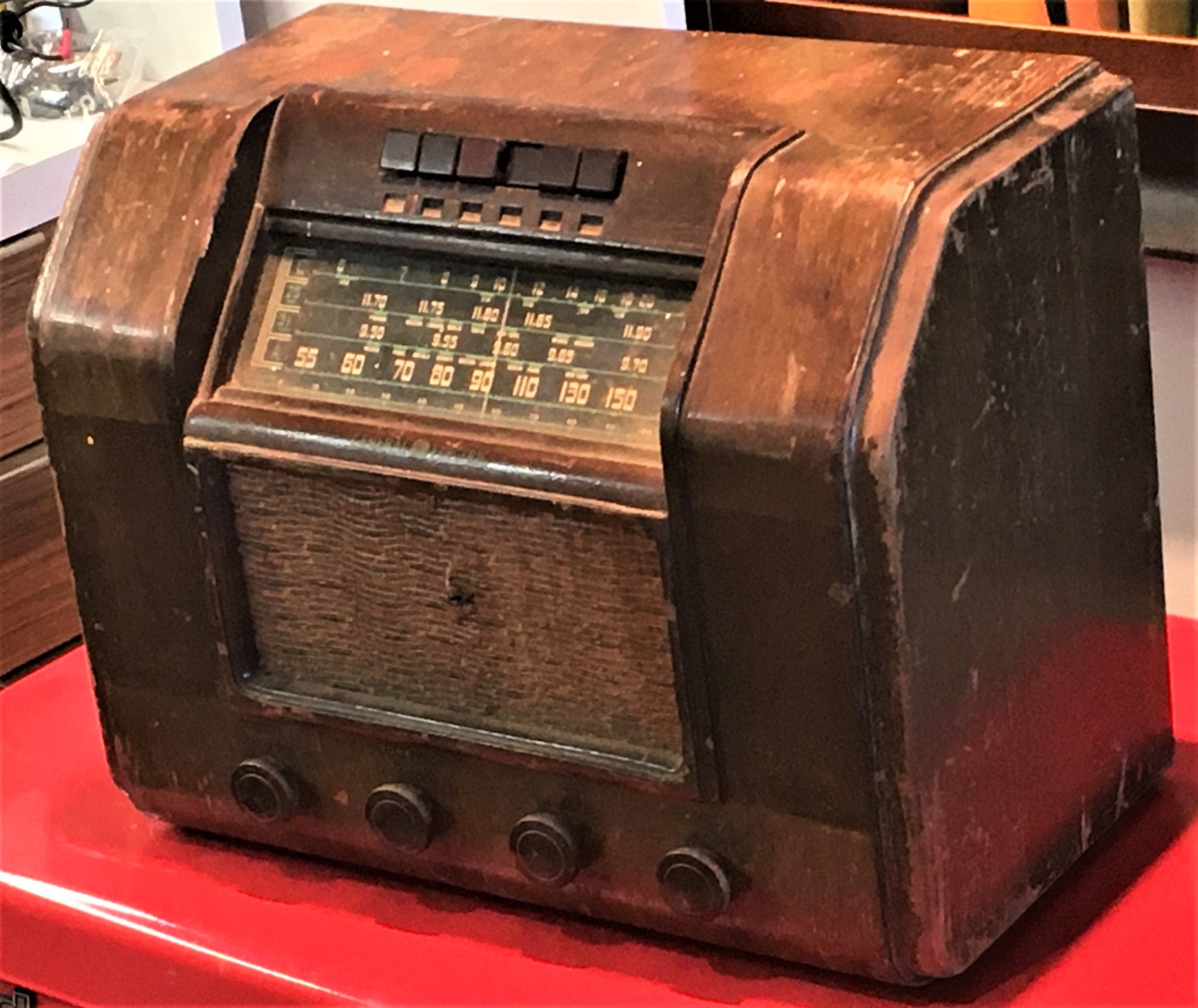

    My neighbour has taken an interest in refinishing furniture and so I gave him the cabinet from a Canadian General Electric KM-60 (also sold as an RCA A24) for practice. He stripped and sanded it, filled the holes, toned it back to its original colours, put on a new decal (a couple tries like we’ve all done), applied half a dozen coats of lacquer, rubbed it out with #0000 steel wool and paste wax, shined the knobs, and made little labels for the buttons. I think he did a great job.
    I recapped the chassis for him and made a simple stereo/mono mixer cord (2 x 100 ohm resistors in a little in-line cardboard tube). The radio sounds particularly good with his smartphone plugged into the phono input.

    Very very nice.
    It does not look like the same radio.
    The grill cloth looks good on that radio.
    You should get him to do all your cabinet work,or show you how he does it.
